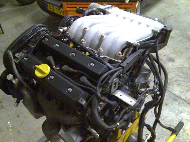

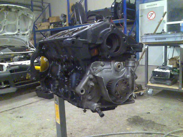

After that the engine just gave up being "on fire", when driving 120 km/h and hitting the pedal, practically nothing happened, took me like a minute to go to 130. You get it, not good! Normal people would go to a garage and let it get checked. I decided to do something more drastic, like a new engine. First of all i was looking for a C20XE M2.8 with coscast, but after some research i came to the conclusion that a full restauration of this engine would cost a lot of €€ and time. So i was thinking, when spending money, why don't spent it good! So before you knew it...the order for a X30XE was placed and i was bringing away the car. Here comes the story:

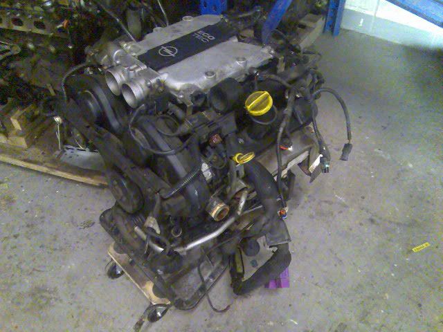

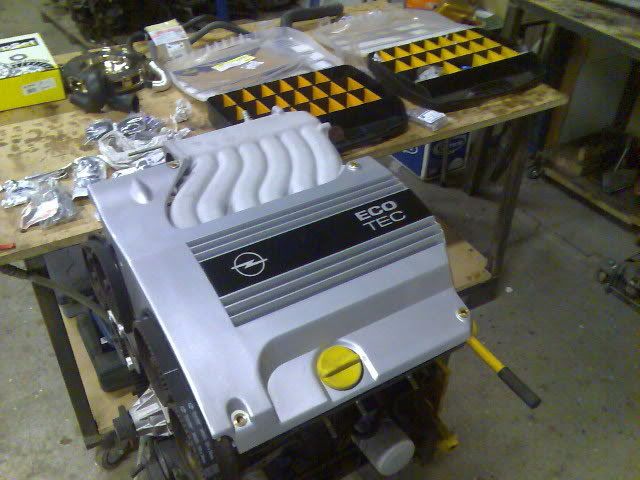

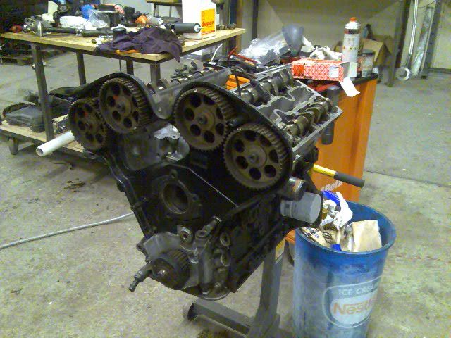

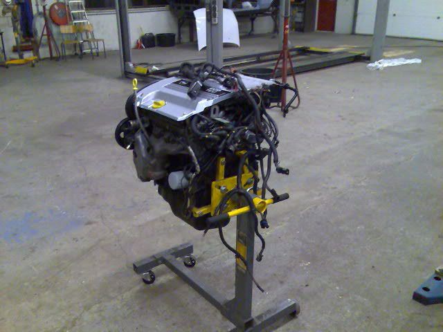

We take an engine from an Omega B

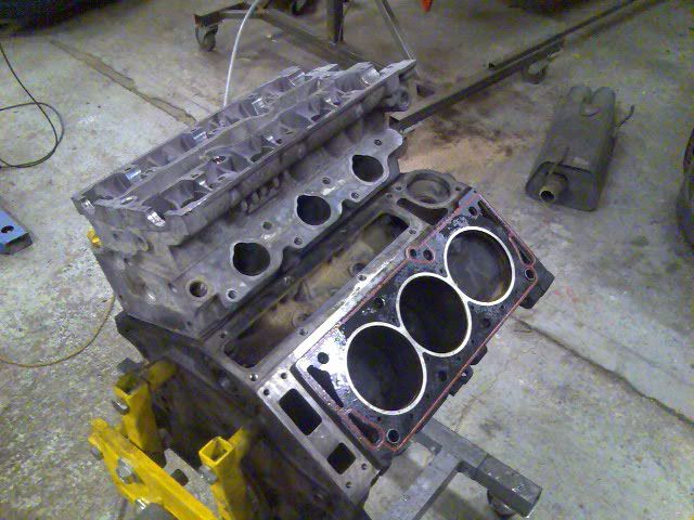

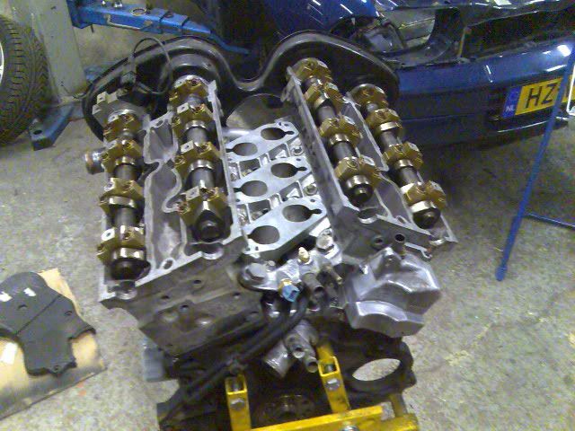

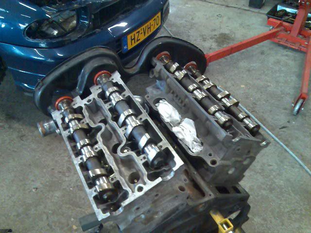

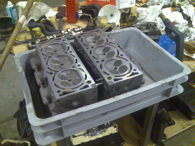

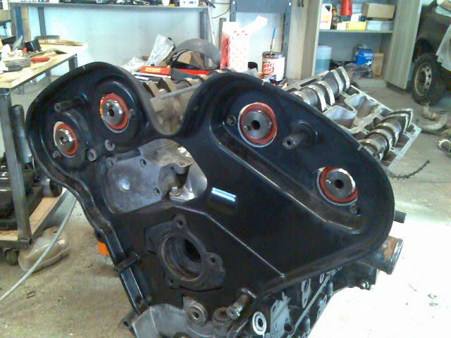

And strip it completely

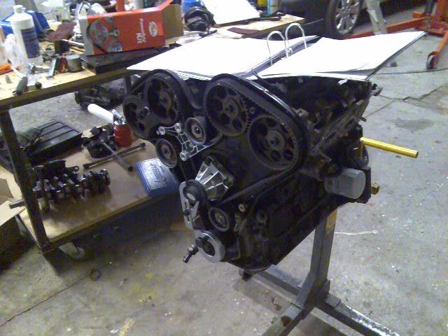

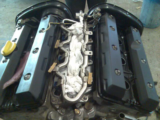

And start building again

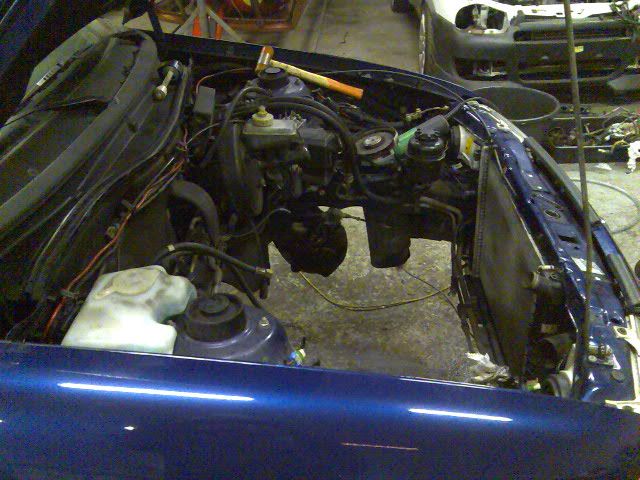

In the mean time, the old C18XE had to make place offcourse
And 1 hour later

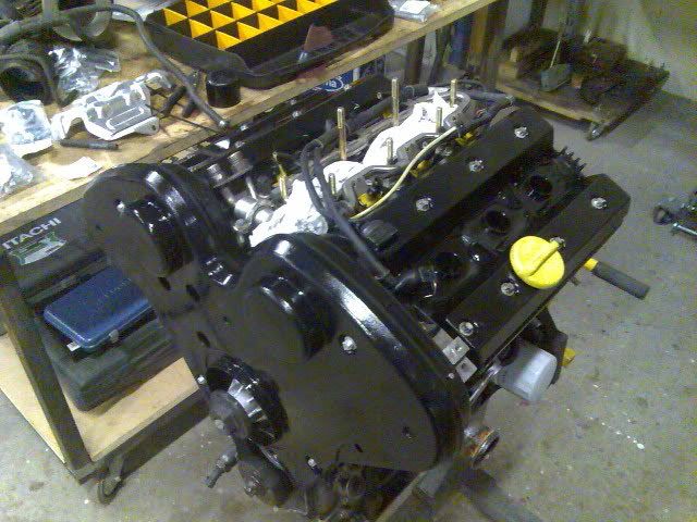

Continue to built the engine

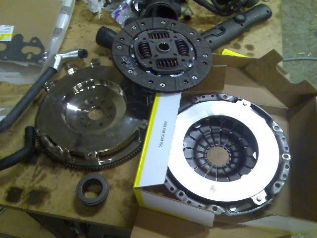

New clutch and flywheel ;)

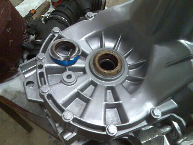

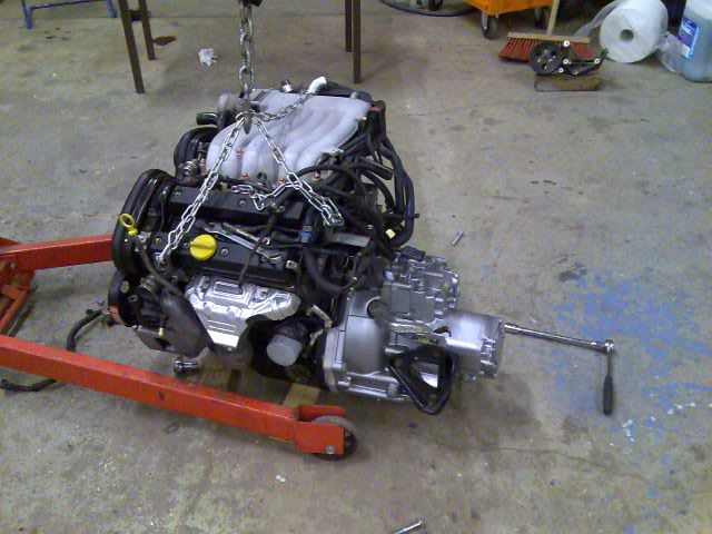

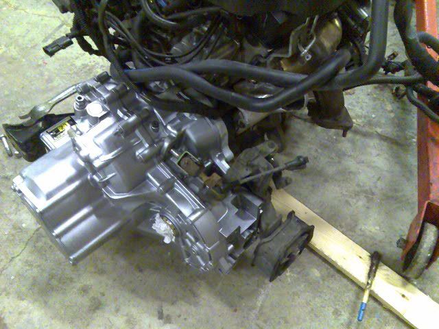

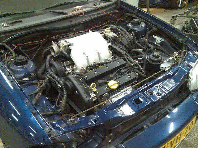

With all this power, I also need a new gearbox, obviously i went for the F28

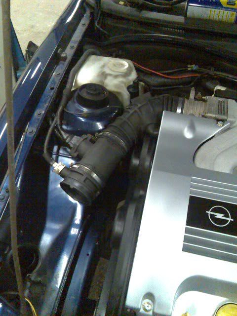

And in the car 8)

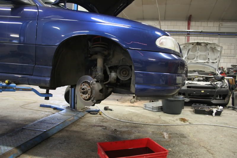

Old GSi brakes are no good with this power
So we go for something bigger

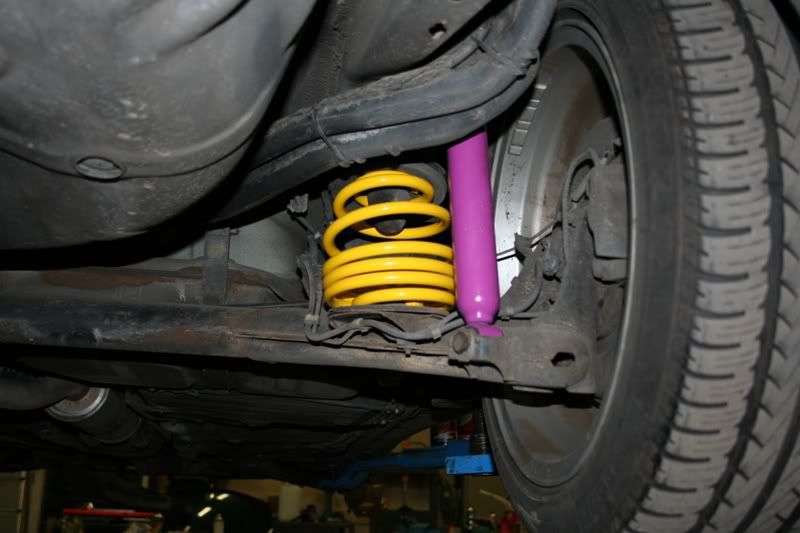

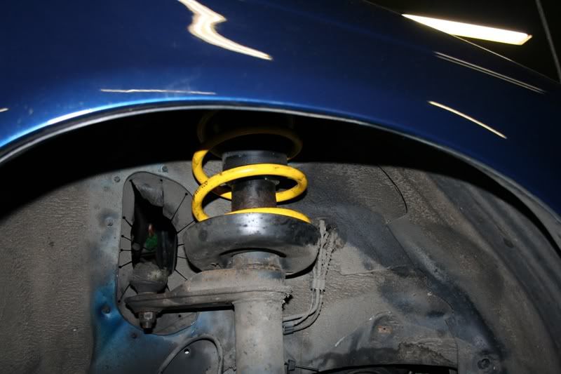

Also new suspension:
And the result 8)
