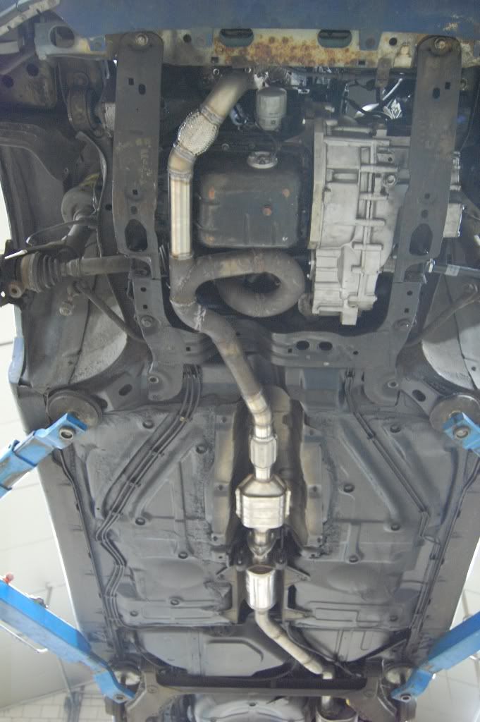

Ok, as promised, some updates.
Since yesterday, the car is again in the shop. The gearbox wasn't doing, what it should be doing (shifting gears normally). But it was all in the contract, so no extra costs except some time without the Astra.
Well, to the point:
Installed Bonrath Power Lifts. These things are incredibly strong
New audio. Sold the old sub + amp. Wanted to go back to original
Irmscher rear lights
Conversion to fitt original Calibra Turbo rims (don't mention the height, i know, the car is high. Using Vectra A V6 springs now till i have new ones that lower the car a couple of cm again)
Installed new Sachs sports clutch that can go upto 500 hp, the old original one couldn't handle the power, it kept slipping and when it came out (after 1 year of usage) it turned completely blue
Also installed a new exhaust system (Group A, 63,5 mm) and new driveshafts from a Calibra, because these things also couldn't handle the power
Old stuff:
New stuff:
Well, to the point:
Old stuff:
New stuff:
http://i206.photobucket.com/albums/bb21 ... tlaat4.jpg
